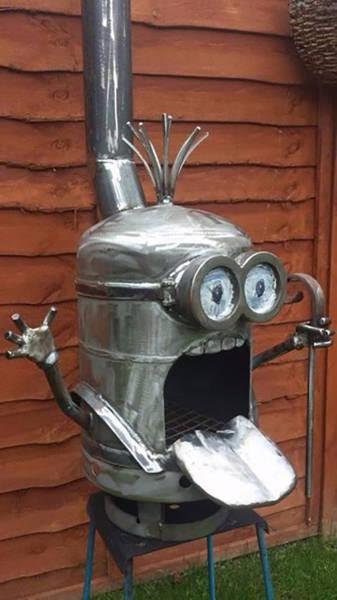

RE: Teeme ise söegrilli - Basilio - 26-06-2015
[attachment=53921]
RE: Teeme ise söegrilli - mlsluik - 26-06-2015
See viimane on ka ikka eriline kunstükk..  Toungue Big Grin
