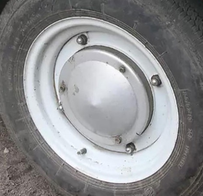

Zaz 968-kus on tsentrirõngas?

Piduritrummel.
