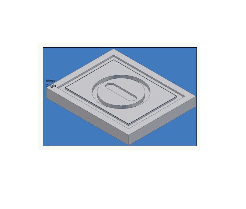

Töötlemisprogrammi kirjutad ise kui oskad programmeerida ja omad vastavat tarkvara ja teadmisi.Puhas matemaatika, geomeetria........
Näide:
*RECTANGLE AND CIRCLE
*Material - MDF
*BILLET LENGTH X - 110
*BILLET WIDTH Y - 90
*BILLET DEPTH Z - 12
*(OP 1 TOOL 5 5MM SLOT DRILL)
N10 T5 'Select tool.
N20 S2000 'Set speed.
N30 G0 Z6 'Rapid move to Safe Height for Horizontal Rapid Movement.
N40 G0 X69 Y45 'Rapid move across until above material entry point.
N50 G0 Z2 'Rapid move down to height for change to feed rate.
N60 G1 X69 Y45 Z-2 F75 'Feed into material to a depth of 2mm.
N70 G1 X41 Y45 Z-2 F300 'Cut the slot.
*(OP 2 TOOL 5 5MM SLOT DRILL)
N80 G0 Z6 'Rapid move up to Safe Height for Horizontal Rapid Movement.
N90 G0 X55 Y70 'Rapid move across until above material entry point.
N100 G0 Z2 'Rapid move down to height for change to feed rate.
N110 G1 X55 Y70 Z-3 F75 'Feed into material to a depth of 3mm.
N120 G2 X55 Y20 R25 F300 'Cut the circle: two G2 moves. Could define circle in one line using I J format code.
N130 G2 X55 Y70 R25 F300
N140 G0 Z6 'Rapid move up to Safe Height for Horizontal Rapid Movement.
N150 G0 Z50 'Rapid move up to Tool Change Height.
*(OP 3 TOOL 6 6MM SLOT DRILL)
N160 T6 'Select tool
N170 S2000 'Set speed
N180 G0 Z6 'Rapid move down to Safe Height for Horizontal Rapid Movement.
N190 G0 X10 Y10 'Rapid move across until above material entry point.
N200 G0 Z2 'Rapid move down to height for change to feed rate.
N210 G1 X10 Y10 Z-4 F75 'Feed into material to a depth of 4mm.
N220 G1 X100 Y10 Z-4 F300 'Cut the rectangle: four G1 moves.
N230 G1 X100 Y80 Z-4 F300
N240 G1 X10 Y80 Z-4 F300
N250 G1 X10 Y10 Z-4 F300
N260 G0 Z6 'Rapid move up to Safe Height for Horizontal Rapid Movement.
N270 G0 Z50 'Rapid move up to Tool Change Height.
