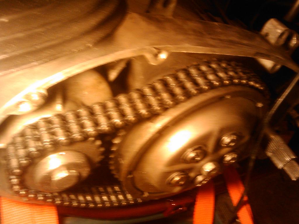

Hello everyone. I have seen that the double chain connecting the output of the crankshaft to the transmission clutch is attached only by one strand.
I guess this is wrong. They seem not aligned. How can I fix it?
If I have to pull the clutch, as I do?
Thanks
It could be wrong clutch basket for this bike. As I can see the bike is an IZ. Clutch baskets are not interchangeable between Jupiters and Planetas, so the problem might be that you have installed wrong clutch basket there.
Hello Rallitaja. You mean that you may have installed a clutch basket of the izh planeta.
My bike is izh jupiter 2k
Yes, its probably Planeta's basket in there.
