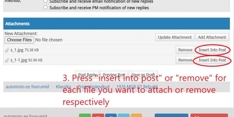

Ok Ive edited this post to test the photo upload, seems to work ok, just!
When posting, choose button nr. 14 from the left (above the text box) and then paste url of the picture to the box called "URL:" after that push the button "Lisa" below.
Or you can upload your images directly to forum's server.
This ensures that images lifespan will be likely as long as forum's existence and do not depend on external hosts which, as time has shown, tend to disappear thus leaving us with broken images in forum posts years after.
