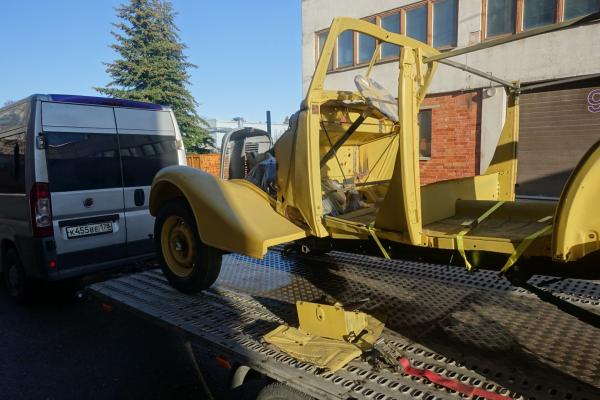

[Pilt: 202556026_3974622359259849_4079839869816...e=60D05F2E]
