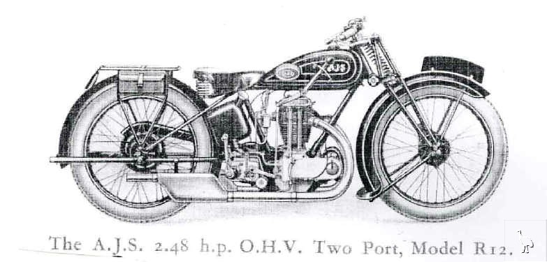

Hi Veikko,
I just love bikes like this, it shows to what lenghts people in eastern Europe went to keep things going when there were no spares around. In fact this AJS is a relatively good survivor - I've seen much greater horrors in Hungary. Your AJS looks to be a 1930 250cc R12. The frame is the 250cc type as the saddle tube goes to the front of the gearbox casting and not between the two stud holes as on 350 frames. There should be a brass plaque on the engine crankcase driveside giving the engine no but this often has fallen off. The gearbox is not correct (the original No2 AJS box was weak) and although it looks like a Burman, more probably is a German type (Pfeifer etc). The forks look OK and front wheel maybe correct, not sure about the petrol tank, oil tank is of course wrong, rear wheel is wrong (thats some rear sprocket!), rear frame lugs look modified. But its a worthwhile project and could make a lovely bike.
Regards
John

Tänu Veikkole ja tema tutvustele on siis välja selgitatud, et tegu on AJS R12 aastast 1930. Uurisin veidi ja leidsin sama mudeli, mis olla juba '29 aastal tehasest väljunud, muidugi R seisab 1930. aasta eest. Leidsin numbri 136777, mis peitus paksu õlikihi all, mootori plokilt.
Kõik jutt õige ja arvatatavasti kuulub tagaratas New Imperialile, samas hakkab mind aina enam huvitama selle tsikli minevik ja kunagised omanikud.
Tegelikult on mul veel hulganisti küsimusi varuks, mis puudutavad selle ratta taastamise protsessi ja asjade käiku, ilmselt peaksin tegema uue teema kuhugi.
Ja veel, kas Eestis eksisteerib mingil näol Inglise tsiklite klubi vms.?
Sellise lingi leidsin: http://www.batorauctions.com/Atlantic_AJS_Model12.htm
ja hägune kataloogipilt:
