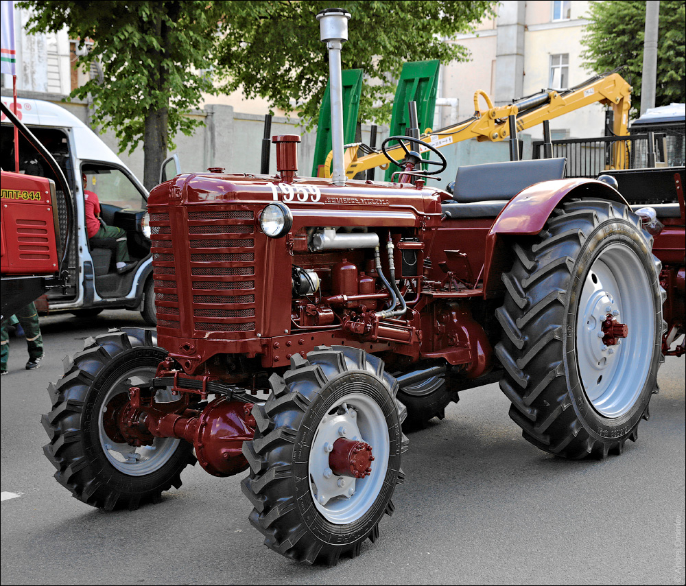

Mis silinder MTZ 7'l küljepeal on?
Your mama might be proud of you, but this ain't your mama's world.
Postitused: 1,181
Teemad: 56
Liitus: Mar 2012
18
Tagaveljed ja rehvid pole MTZ- 7-me originaalid.
