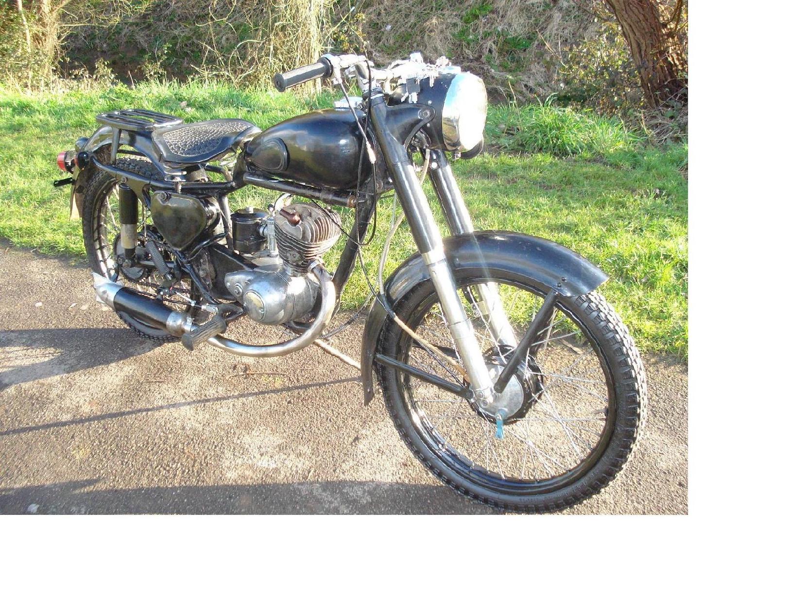

Maybe Mike would be so kind and post some pictures of his motorcycle? It would help alot in determinating erra correct details on the bike!
Yes Maz, I would like to send some pictures for you all to see, I am not so good on the computer so maybe my daughter can do it, but shes away until sunday.
Today is nice day with some sun so I can take the pictures today and post them maybe Sunday.
mike

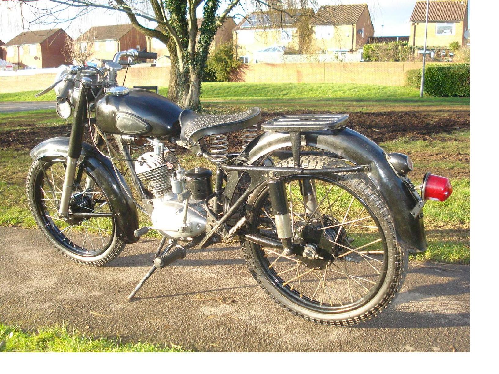

So here are 2 pictures of monster minsk!!! These were taken on friday. Let me know what you think.SmileSmileSmile
Thanks for the photos!
Beautiful, glorious, miraculous! Cool Especially the green grass! Toungue
We have some snow here at the moment.
The bike needs some stripes, more stripes and Minsk - logos on the tank, the muffler/silencer is not exactly from M103 model too. (We are here some kind of "original - freaks".)

And at last - the big red tale-light, it is very funky! Smile

I see what you mean about the muffler it is different to the original !
the big red light on the back is my work Big Grin I had to put on a break light for the English safety test and could not fit a double fillament bulb in the original light, so now I have 2 tail lights one in each and break light in the big one. you can just see the break light switch in the other picture, theres a little red wire showing, I must do better next time !!
