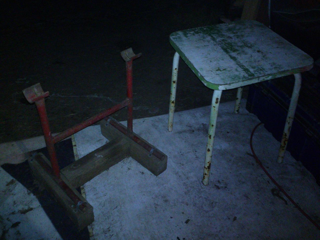

KROSSIKA PUKK ÜLESTÖSTETAV DIY -
overspeed - 22-03-2015
Siiani olen omanud krossikale pukki, mis on statsionaarse körgusega ning krossikas tuli sellele lihtsalt peale sikutada. Ikka olen vaatand teistel neid ülestöstetavaid pukke ja möelnud, et peaks ka sellise muretsema. Poes ca 56€ ... 120€ maksev pukk pole ju ka väga hull osta, kuid otsustasin teha ise, sest nii on hea vöimalus taas keevitust harjutada (harjutan TIG keevitust, tekstis allpool mainib, et tegi MIG keevitusega), muidu ju seda praktikat keevitusel pole ja kui teinekord vaja miskit kriitilisele kohale keevitada (tsikli raami), siis käsi väriseb ja tuleb "sitanikerdis". Seega ...

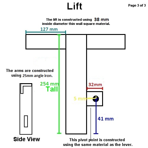

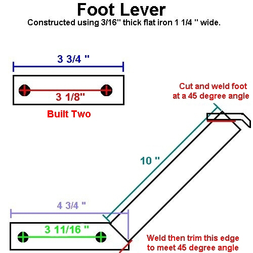

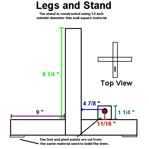

... selle asemel et peast hoovastiku möötude arvutusi teha, sobrasin natukse netis ja leidsin joonised:
[attachment=52838] [attachment=52839] [attachment=52840]
[attachment=52841] [attachment=52842]

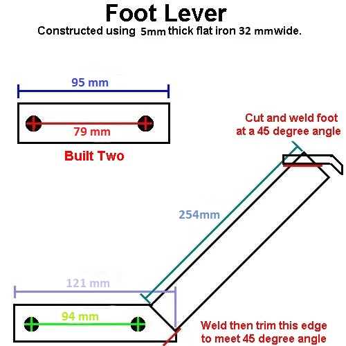

Tekst jooniste juurde oli alljärgnev:
Here’s some instructions to build yourself a foot lift. I’ve broken them done into four parts: the legs and stand, the foot lever , the lift and assembly. Just click on the section of the plan you’ll be working on and print them off. You should be able to find the materials at any metal supply shop for $10 or $15. If you can’t find the materials listed you can always substitute them with others just insure the stand slides into the lift with as little side to side movement as possible and remember the stand should be portable so use an appropriate wall thickness. There’s no sense building a 100lb stand.
Tools - You’ll need a welder ( a MIG works great ) , cut-off saw, ruler, scribe , square and some basic hand tools. If you don’t have access to a cut-off saw a hacksaw will work. Sorry I don’t expect you’ll be able to substitute duct tape for a welder.
The plans are sized specifically for a 1995 to 2000 KDX, 10.5" tall when in the lowered position. If you’re building it for another bike simply measure your bike's ground clearance and adjust the height of the stand’s lift arm accordingly.
I built the platform out of ¾ plywood and covered it with ¼" rubber. The platform is 12" x 8". The three main parts just bolt together, check out the picture.

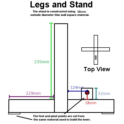

Natukse ümberarvutusi ja arvutiga klöbistamist, ja sain joonised tollidest millimeetriteks:
[attachment=52843] [attachment=52844] [attachment=52845]
Tekstis siis vastavad kohad:
There's no sense building a 45,5 kg stand; ...267mm tall when in the lowered position; I built the platform out of 19mm plywood and covered it with 6mm rubber. The platform is 305mm x 203mm.

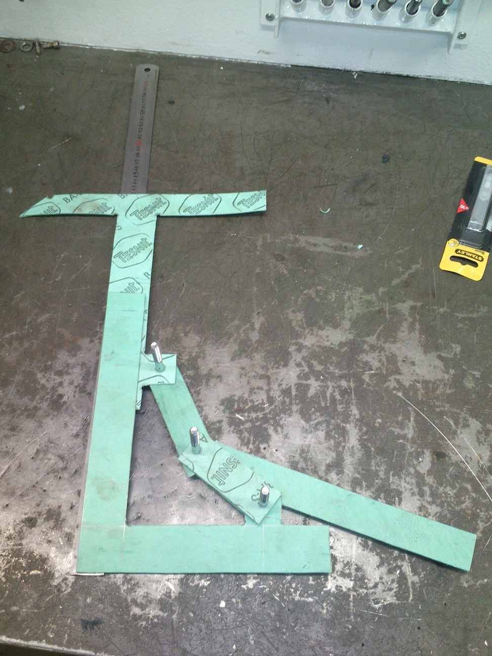

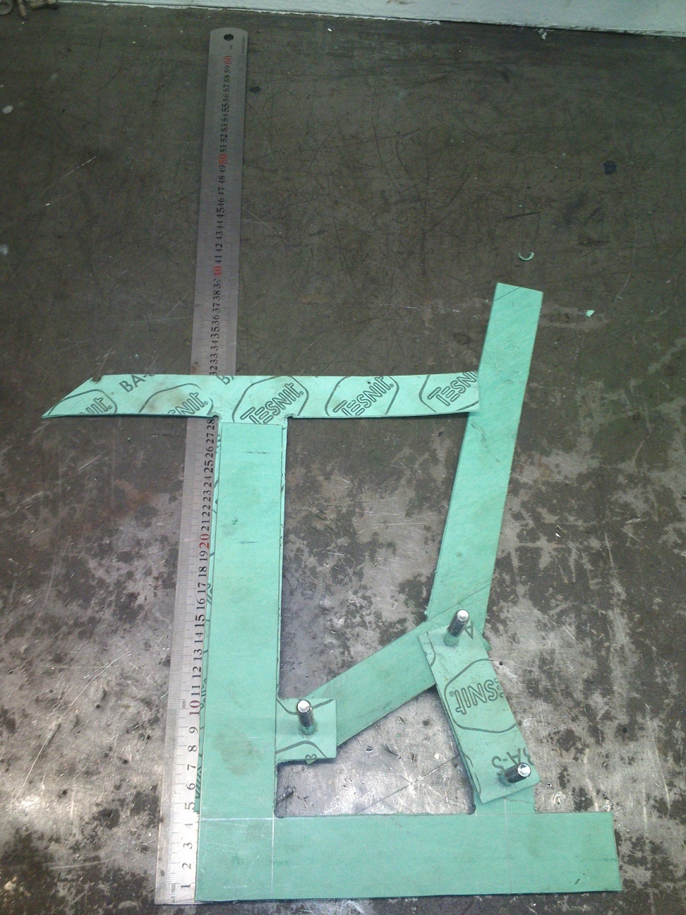

Hakkasin siis pihta proovišabloonidega. Kuna tekstis ei räägita, kui palju töus on, tahtsin selle üle mööta. Selliste möötudega liigendil tuleb puki töus 11 cm.
[attachment=52846] [attachment=52847] [attachment=52848]

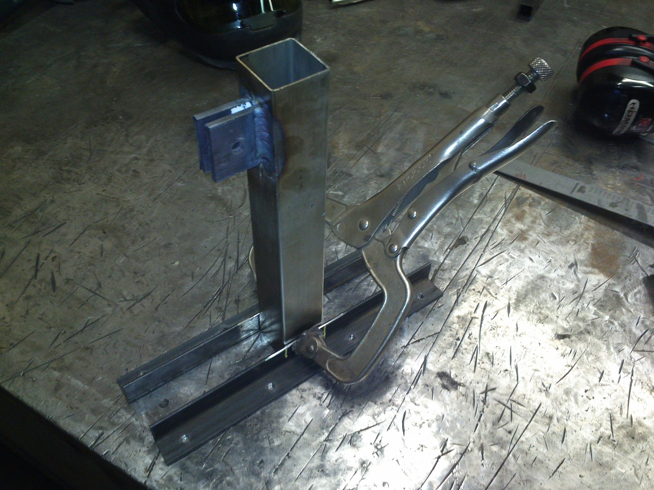

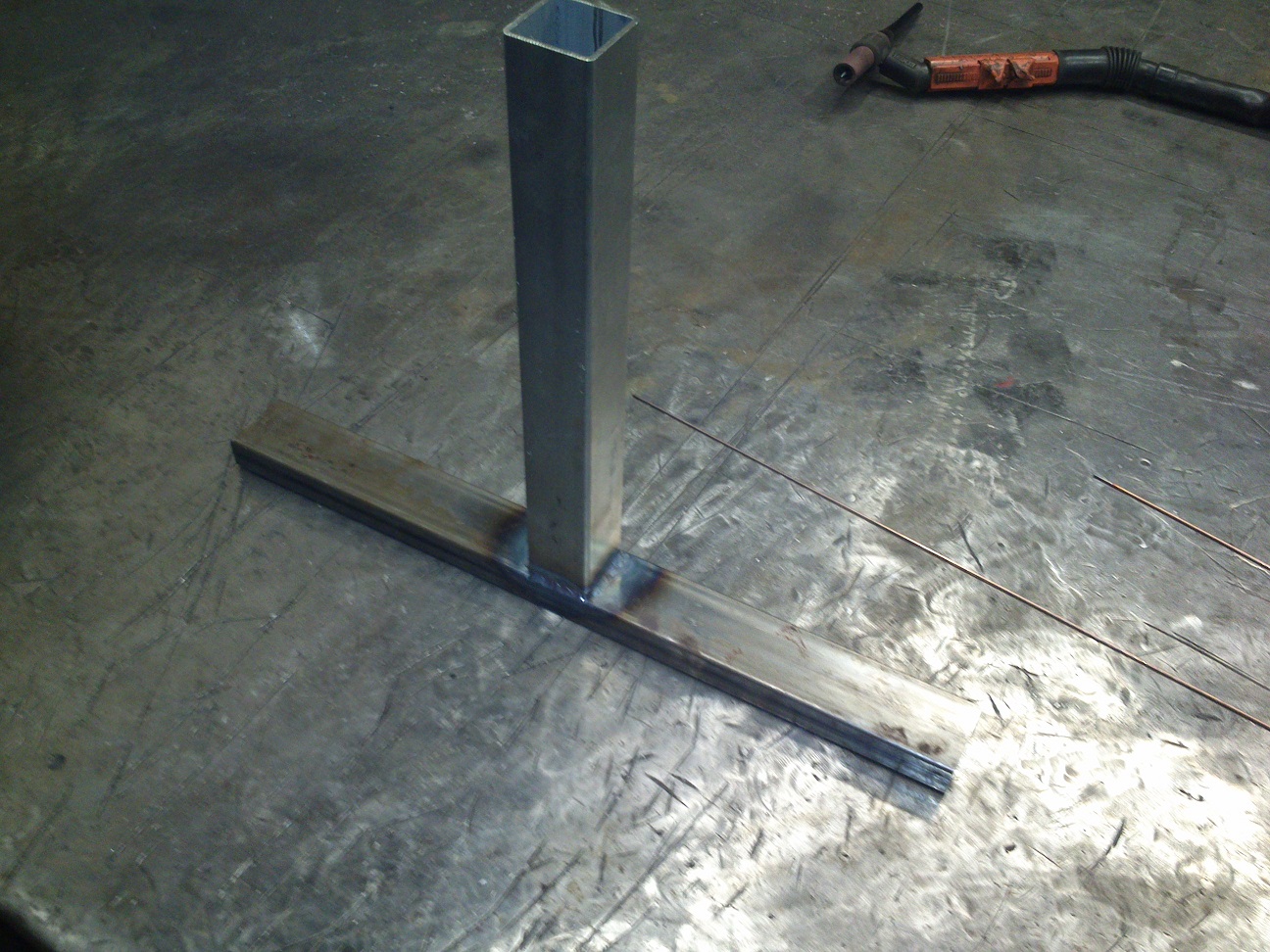

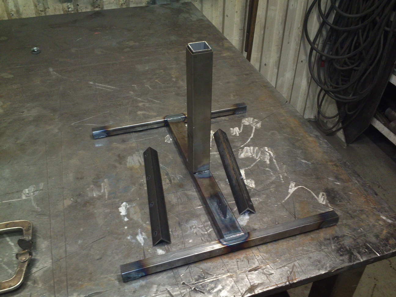

Puurisin augud vajalikesse kohtadesse ja valmistasin detailid keevituseks ette (versengid, puhastus). Siis vöis keevitusega pihta hakata:
[attachment=52850] [attachment=52851]

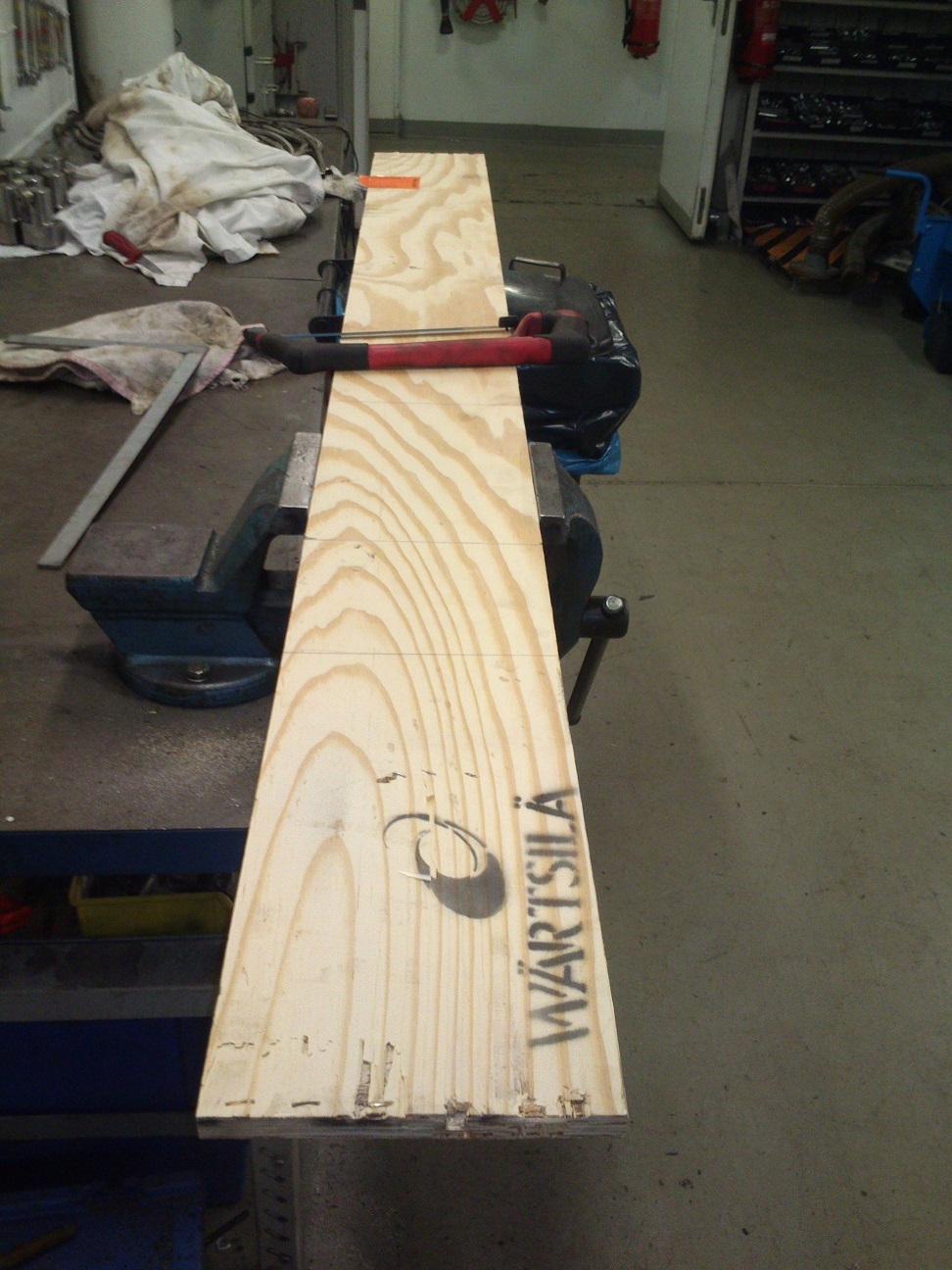

Vahepeal raud jahtus, siis tegelesin puidutööga. Kuna ma vineerisaagi töökojast ei leidnud, siis sai vineer saetud rauasaega:
[attachment=52852]
Keevitusega edasi:
[attachment=52853] [attachment=52854] [attachment=52855] [attachment=52856]

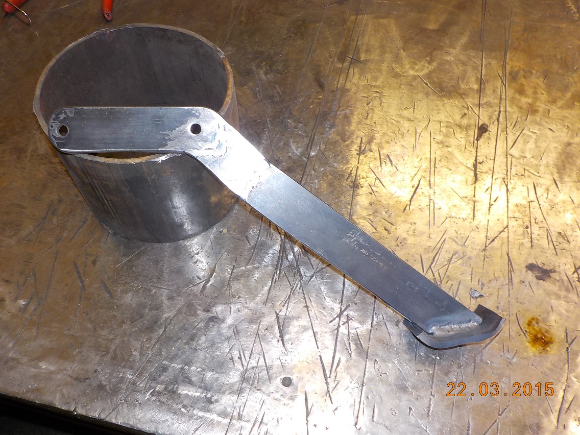

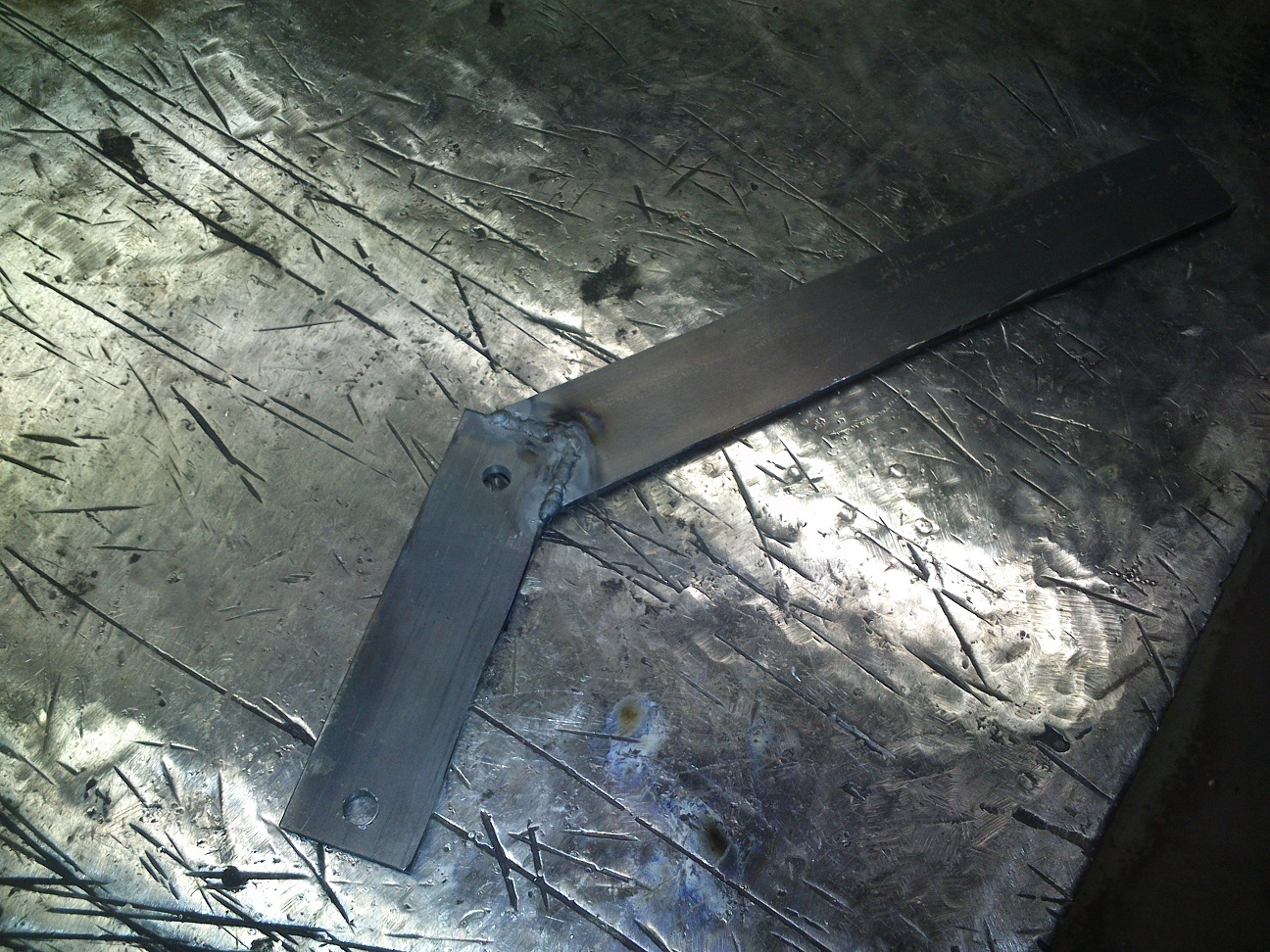

Kui pukk ise enamvähem valmis oli, jäi veel teha töstehoob.
[attachment=52857]
45 kraadi hoovale ei sobinud mulle, proovil jäi hoob vineeri vastu. Löikasin sellele sälgu sisse ja muutsin nurka natukse suuremaks.
[attachment=52858] [attachment=52859]

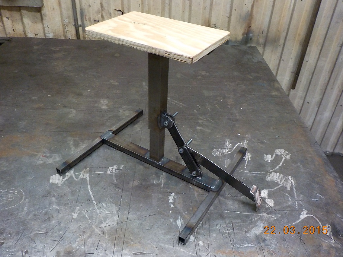

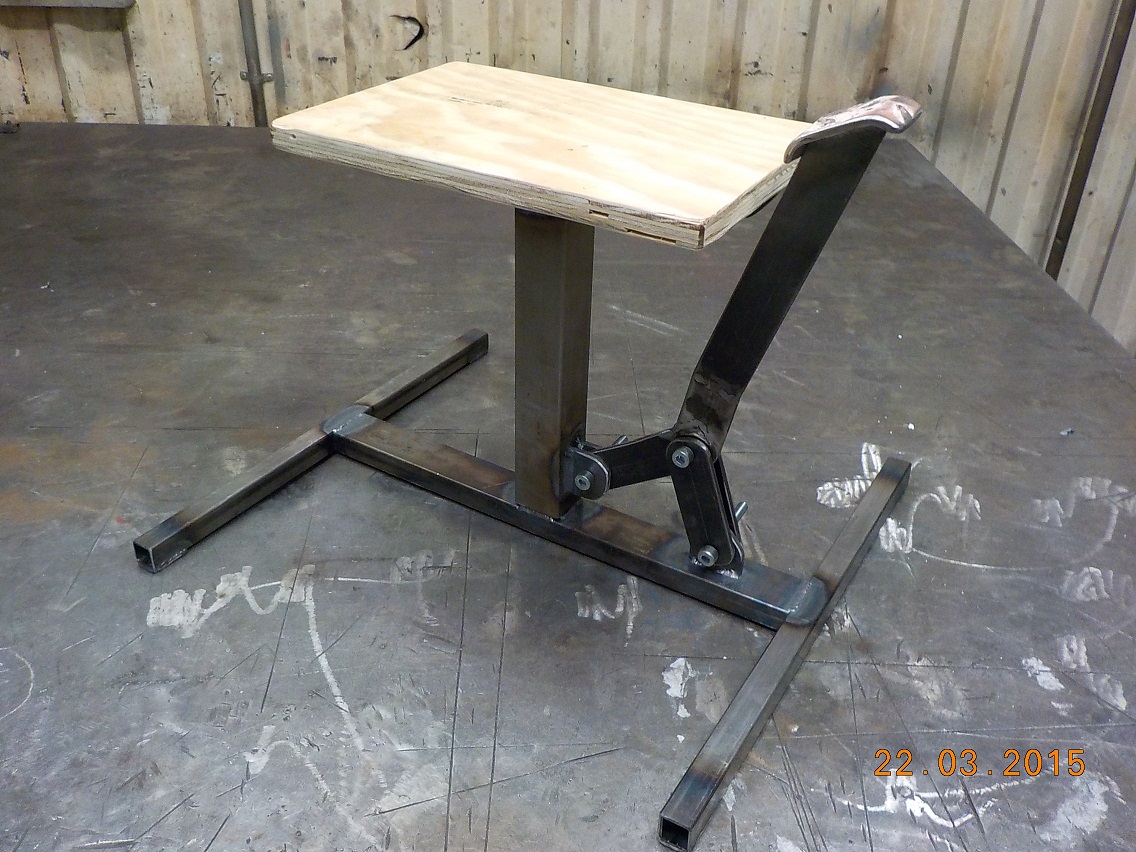

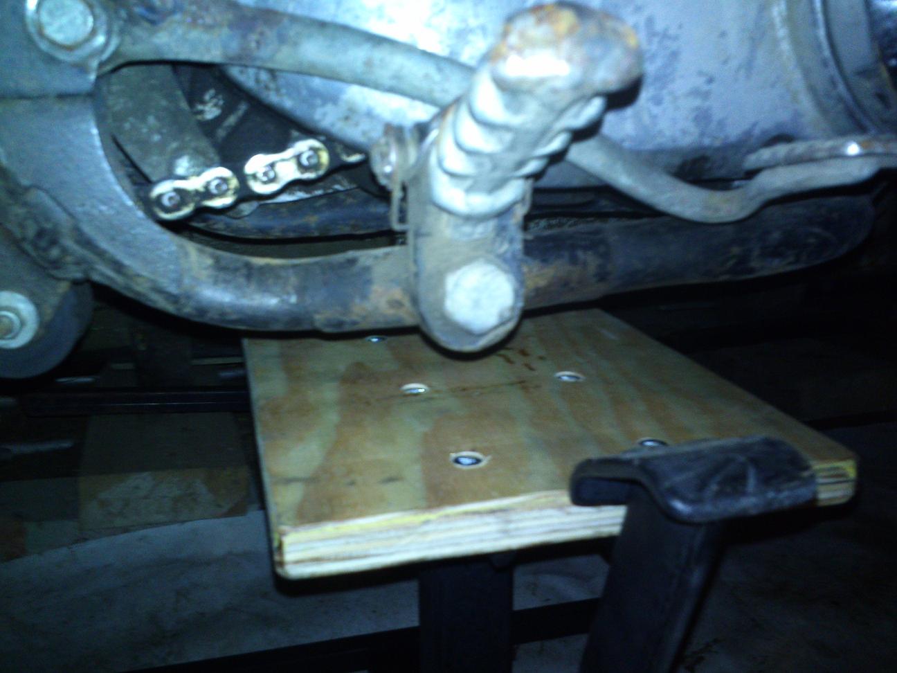

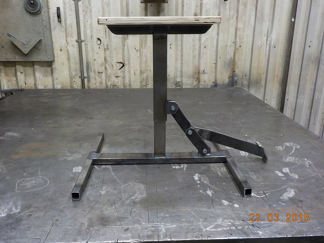

Ning valmis ta oligi.
Testimisel, kui 100 kg mees peal seisis, tundus asi liialt raske, töstehoova alustusnurk on liialt püsti. Kuid tsikli puhul see ei ole sama, sest mul on 2 cm vaba ruumi ennem kui platvorm pöhja puutub ja koormust saab ning algul kerkib tsikkel ka vedrude abil paar cm. Selleks punktiks on aga töstehoob juba piisavalt hea kalde all et pealevajutades pole enam nii raske tsikkel ülesse tösta.
[attachment=52860] [attachment=52861]
[attachment=52862] [attachment=52863]
Nüüd peab veel leidma kuskil vajaliku käiguga amordi, mis töötaks kokkusurumisele, et tsikkel alla tuleks sujuvalt. Ideelt tuleks selline:

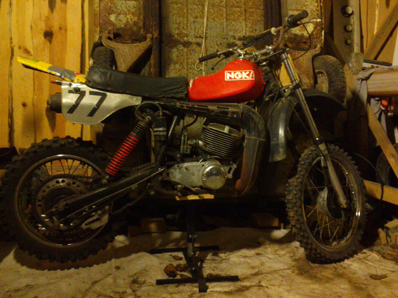

overspeed - 27-03-2015
(22-03-2015, 15:04 PM)tiit Kirjutas: Tahtsin juba algset overspeedi postitust kommenteerida, aga nüüd ei saa kuidagi mainimata jätta, et kolmjalg ei kõigu kunagi.
Loomulikult mötlesin ka kolmjala peale (kuna ta ei köigu jalgadel kunagi), kuid ta tundus ebastabiilsem
kui ise ka otsa ronida masinale (isiklikud kogemused kolmjalg taburettidega vs nelijalg taburetid).
Seepärast otsustasin H-jala kasuks.
Kummikate plaadile on veel peale liimimata ja amorti pole jöudnud vaadata, kuid testima pidin, sest pukk sai ehitatud töö juures ning peast polnud mul örna aimugi mis möödus pöhja laius oli. Teadnud vaid, et vabakörgus on 35cm sai pukk tehtud 33 cm körge ja 2 cm vaba-ruumi allasendis on täpselt paras, ja laiusest piisab (vineeri saab ka alati suurema löigata).
Körgused klapivad mölemale tsiklile kenasti, seega tuli universaalne värk
[attachment=52922] [attachment=52923] [attachment=52924]
[attachment=52925] [attachment=52926]
Seega vanad pukid vöib nüüd pensionile saata:
[attachment=52927]

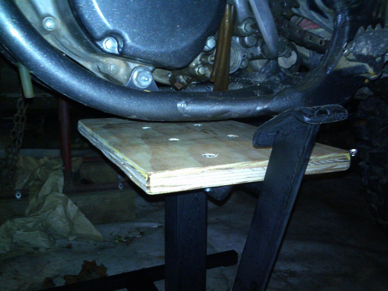

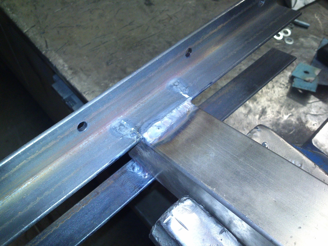

Mitte et viriseda tahaks aga natukene jäi keevitus häirima.
Pigem kasuta veidi suuremat voolu ning keevita kiiresti kui see, et alguses kuumutad ja kuumutad ning lõpp valgub laiali .
Lisaks Tigi puhul soovitan rohkem eeltööd teha. Detailid ilusti faasida ja täpselt kokku panna. Siis kulub täidistraati ainult faasi jagu ning õmblus saab tugevam ja peale ei teki "mäge" .
Aga muidu tubli töö ning harjutamine teeb meistriks

(04-05-2015, 20:44 PM)Gravity Kirjutas: Mitte et viriseda tahaks aga natukene jäi keevitus häirima.
Mul just see harjutamise vajadus ongi
Käsi ei liigu veel nii hästi, et saaks rohkem voolu ja kiiremat käiku kasutada, seepärast madalama ampriga teengi. Eks harjutades saab sinnapoole püüelda.
Tegemata versengid olid puhtalt oma laiskus.
